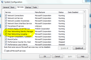

To enable peer networking just go to start/search then type in 'system config' hit enter then go to 'services' scroll down to peer networking and set too enable then hit the 'apply' button to turn on the peer networking functions, like I have highlighted in the picture below.
You can join a homegroup in any edition of Windows 7, but you can only create one in Home Premium, Professional, Ultimate, or Enterprise.
Ok i found where they are... they are all checked (everything on the list is checked) however next to Peer networking Grouping, it is checked but says it is stopped.... how do i get it to run?

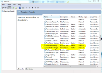

Ok go to start/search and type in 'services' then hit enter, scroll down and find and click to highlight peer networking and restart the service, it might help to set it to automatic start up but usually the manual start up works.
To enable automatic start up just right click on it than choose properties, then where it says "start up type' it might help if you change to automatic start up. I'm not sure why it would be disabled in the first place but maybe the manual start up isn't working because of your AV software.
Alright, went and did that.... it was on automatic, and i tried to hit start.... didn't work came up with en error. Went to manual... didn't work got an error
The error was this
"Windows could not start the Peer Networking Grouping service on Local Computer
Error 1068: The dependency service or group failed to start."
