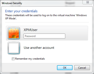

XPMUser is an user account automatically created when installing XP Mode. If no logon credentials are saved, you should see this when starting XP Mode:
Just give the password you chose when installing XP Mode.

Only way to add XP Mode users is to start XP Mode, go to XP's Control Panel and add user accounts there. If you have done this, click Use another account when logon window opens (see the image above) and give that username and password.

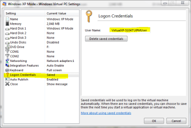

To see which logon credentials are saved, if any, check the settings of XP Mode.
