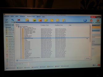

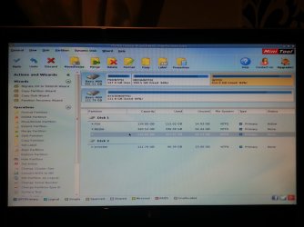

Get Partition Wizard free bootable and take couple of screenshots, make sure all details included and columns are seen for both SSD and HDD.
Also backup the working ones as soon as possible.

On the first picture, the partition with no label (it always had no label, so that is expected behaviour) is the faulty, inaccessible partition, which seems to be showing fine in Partition Wizard. Disk 1 is HDD, Disk 2 is SSD. On the second image, I have decided to shoot the folder structure of the inaccessible partition as there are some weird folders on there that I haven't seen before it failed (but the dates say August, so maybe they we're hidden).
What is the best tool to backup those files?

I see Program Files/Program Files (x86) and another Program Files (x64) there. Possibly why some programs not working. Also see 1st screenshot HDD Partition 1 (FSX) is set as Active, so boot files are there. That's why it doesn't boot with SSD alone. Lets fix that 1st.
Install EasyBCD on to your SSD. And move bootmgr to System (SSD) - should be C. http://www.sevenforums.com/tutorials/209885-bootmgr-move-c-easybcd.html
Shutdown and remove HDD (unplug the power cable). Also move SSD to first SATA port (SATA-0 or SATA-1 as called by motherboard manual) and see if you can boot.
Do you have another 1TB HDD to clone to? http://www.sevenforums.com/tutorials/73828-imaging-free-macrium.html (but clone instead of image the drive). Also create its bootable CD/USB and clone from the bootable environment.
Regarding Found folders - http://www.sevenforums.com/general-discussion/279483-found-000-file-folder-what-does-mean.html
Once you clone the drive, we may deal with the missing partition.
Ask away if anything does not make sense.
