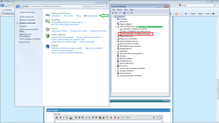

Device Manager
See attached, device manager in Windows 7
No caution yellow exclamation warnings?
Not sure where to find the Driver Profile
Opened up the device properties and couldn't find anything about a Driver Profile.

Are you able to perform screen capture of your device manager?:geek:

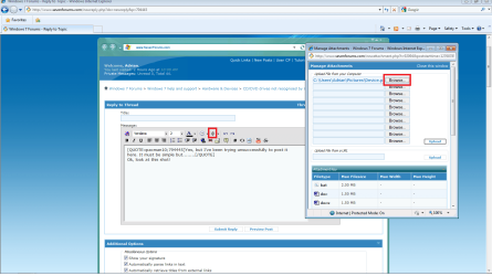

Yes, but I've been trying unsuccessfully to post it here. It must be simple but........
Windows 7 64-bit
Ok, look at this shot!
See the paper clip? I marked it for you in red, browse to the folder where you stored the image. Then upload and post.

Thanks. Here it is.

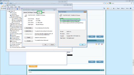

Next, while you are in Windows 7 goback to the device manager and review your device driver for your Drive, here is what mine looks like.
