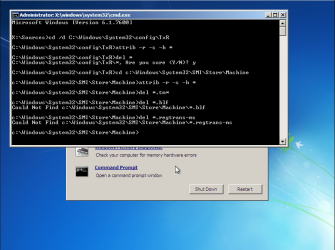

METHOD III (from WinRE level)
//apply only if unable to complete all steps in METHOD II and problem still exist//
   Warning
Mostly cases OS is installed on first partition and WinRE can see it also as C:.If you have installed OS on other partition you have to change drive letter in my commands i.e if you have OS on second partition the proper first command for you will be cd /d D:\Windows\System32\Config\TxR and so on for remains commands below.For precaution you can check partitions status in diskmgmt.msc in your OS,before you boot installation disk
Boot your Windows installation disk,choose language>>repair computer>>command prompt and type:
cd /d C:\Windows\System32\Config\TxR
press ENTER
attrib -r -s -h *
press ENTER
del *
press ENTER
cd C:\Windows\System32\SMI\Store\Machine
press ENTER
attrib -r -s -h *
press ENTER
del *.tm*
press ENTER
del *.blf
press ENTER
del *.regtrans-ms
press ENTER
From WinRE there is no problem to make all commands.As I said before you can ignore error about missing files -you may not have all log files and it's normal
