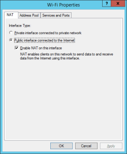

If you open up Routing and Remote Access console on the local Windows server machine and go to your NAT settings.
From there right click your "public" interface or the physical NIC that connects to the 192.168.1.0/24 network and then click on properties. This should bring up a similar properties window as the one below.
From here, click on the address pool tab to show the pool of addresses that NAT can use.
Click on Add to add a range of addresses that your virtual machines will be associated with on your physical network. For example, using your address range it could be something similar to the following:
Once the range has been set you can click on the OK button to add it to the available "public" addresses for use.
After this click on the reservations button to tie an address from the pool you created with the logical IP address of a VM (e.g 10.10.10.2). Once the reservation window is open click on the Add button to add a reservation/IP association.
Now enter in the "public" address that you will use to connect to that VM from the workstation client and the VM's IP address. For example, using your scenario the following could be a valid reservation.
   Note
You must ensure that the tick box is checked in order to allow network connections initiated from the workstation client
Now you can click add,OK and apply to apply the configuration. Equally you can then add additional reservations for each VM that you wish to access.

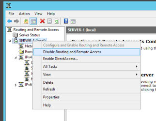

On the main server:
Go into Routing and Remote Access
Right click the server in the left hand pane and click on 'Configure and Enable Routing and Remote Access
Click Next to start the wizard. On the next page click on the 'Custom Configuration' radio button and then click next.
From here check the 'LAN Routing' tick box to enable the routing of traffic between each interface
Now click next and finish to end the configuration. You may be prompted about starting the service. Just start the service if asked.

Remove the network bridge if you have already made one, my apologies :o Also change the IP address of the interfaces back to how they should if they changed. They should return to the original static configurations if the bridge is removed.
On the main server:
Now, with the workstation client (192.168.1.116) the static routes should still be in place with the server as the gateway. Now try to initiate a connection. Remember that firewalls could block the communication so temporarily disable them if you have any enabled.
