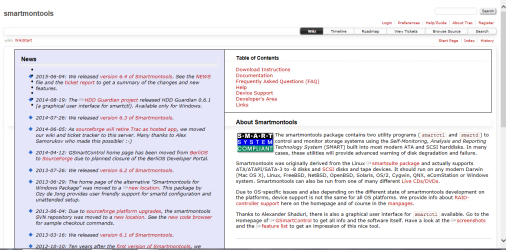

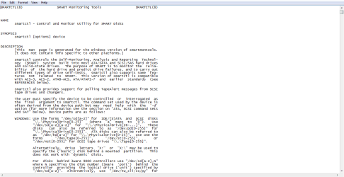

files so that requires me to connect a card reader to my computer so I wanted to get this post to you just in case it causes
another BSOD -- they were happening so frequently yesterday I though it best to shutdown the system for awhile.
smartmontools
