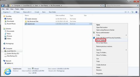

Robert,
Strange. When you right click on the shortcut created using the method in the tutorial, you should have a "Pin to taskbar" option when you right click on it like below.
Hi Brink,
I see your shortcut is an .exe file. That's handled differently than a url. The OS must read the target and treat it accordingly. This must be why the url shortcut can only be pinned to IE or Firefox. I think they got too smart with W7 in some respects. My nephew also took a look and did a google search on this. He found that the code for the taskbar has been written differently and a url shortcut can't be pinned to the taskbar itself.
Now that I know it isn't currently possible, I'll just make do with the "Links" toolbar for my purpose until someone writes a plug-in or MS does a patch that changes this. Hey, you're not one of those application wizards, are you? LOL.

OK, Brink! That's the answer. Not only can you make a shortcut, but you can choose the browser to open in. Your tutorial is very clear (as they all are). This opens up other possibilities with making shortcuts, as well. I really appreciate your time on this. Take the rest of the day off. :D
