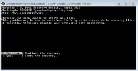

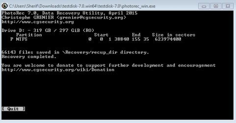

The Data is saved in C: Drive since its free space dropped from 144 GB to 80 GB but i did choose to save them in Recovery Folder in external hard disk....
Where is that recup directory ?!
