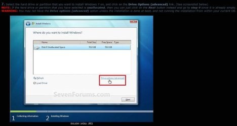

Just use your installer to delete the entire drive to unallocated space, then click next, you can make partitions when your done installing the OS.
Step #6 and #7
Clean Install Windows 7

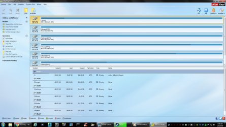

Hook it up, then boot up and post a shot of Disk Management.

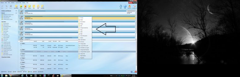

I still have no answer for you on why PW is not getting to the Graphical Interface which should look like this.

You want to Delete, Create a Primary Partition, then Format, and Align the drive.
I do each operation one at a time by clicking Apply up in the left hand corner, you will get a confirmation when each step is done.
So it`s Delete, Apply, Create Primary Partition, Apply, Format NTFS, Apply, Align, Apply
And that`s it.
But let`s say you had 2 Primary Partitions on 1 drive, and 1 partition had all your pictures, you simply don`t do anything at all to that partition.
And PW will even let explore a drive or partition, all done by right clicking on that particular drive or partition.

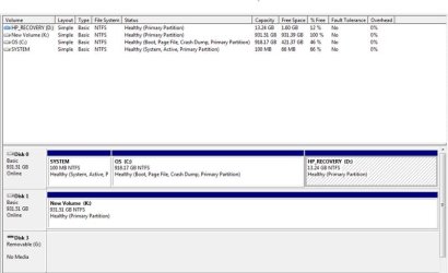

Mike, post a new snip of Disk Management.
Windows does not always assign a letter, who told you it did ??
And let`s not refer to any drives as new or old, let`s say the Windows drive and the data drive, calling them new or old just confuses everyone :)

Here's a new snip of Disk Management.
I mentioned that Windows automatically assigns a letter to a disk because when I connected a new HDD I don't recall ever using Disk Management to assign a letter myself. Perhaps I did via some process or screen that popped up but I just don't recall it.

I don`t think the HP Recovery partition should have a letter. Things can get mistakenly written there if it has a letter. But if it came from the factory that way, then I guess leave it alone.
Assign another drive letter than original (D:) to Recovery partition?
What`s using up the letters E, F, G, H, I, and J ?
Flash card reader ?
If you want to keep all your drive letters in order ( I know I do ) then you could change those letters and any cd or dvd drive letters to the end of the alphabet.
Just personal choice :)
If you removed the D letter from the Recovery partition, you could use it on Disk 1 :)

The HP Recovery partition did come from the factory as D.
E is the optical drive.
F is the External HD.
G, H, I, & J do go with the Flash card reader.
K is the HDD which I was playing with & temporarily put an OS image on, and then just now deleted it.
I just picked up a SSD which will be the new C drive for the OS and programs.
K will become the data drive and I'll give it a different letter.
The original HP HDD will be kept as-is and put aside. While it won't be a clone of anything it could be used in an emergency.
