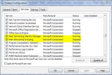

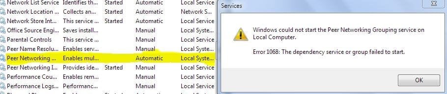

I did what it told me to and that is go to and type this "system.config" into the search start menu, go onto services and enabled "Peer networking Identity manager" and "Peer Networking grouping" I saw that the Peer networking grouping option was stopped and so I went on, and in the search start menu, I typed services.msc and hit enter. I then scrolled down and went onto Peer network grouping and attempted to start that. It unfortunately did not work. It came up with a message and an error:
"Error 1068: The dependency service or group failed to start"

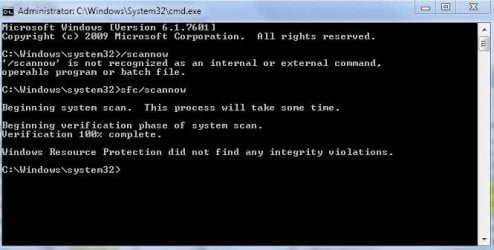

I then did a system scan (I did this by typing cmd into the start menu, running it as administrator, and then typing /scannow. The scan came back clear and said nothing was wrong. :)

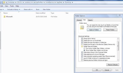

After restarting I went to this location
C:\windows\serviceProfiles\LocalService\AppData\Roaming\PeerNetworking
and I deleted the contents in it. And yet again I did another system restart. However the same outcome appears and I still cannot leave the homegroup. I have unfortunately had to empty the recycle bin as it was too large and the files that was in this location is now lost. :confused:

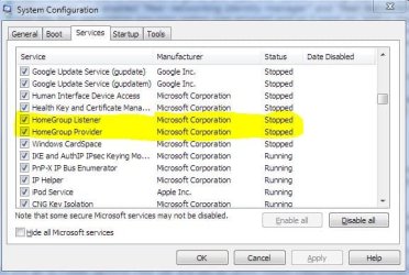

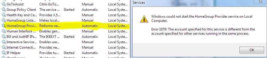

I have noticed recently though that when I type in system.config and go onto services, I have found that Homegroup listener and Provider are checked but are also stopped. < Could this be the case or have I done something else wrong in the process of getting to here? :mad:

Did you go to Folder Options/View tab and set to "Show Hidden Files,Folders and Drives" before you deleted the contents of C:\windows\serviceProfiles\LocalService\AppData\Roaming\PeerNetworking

No I did not show hidden files and folders, I'll try that..... I cannot find "PeerNetworking" Because I have deleted that folder, so therefore if there was anything in it, it has gone now. And as for hidden files and folders, there is nothing else that has popped up.

Yes I have tried to do the system scan and there is a message that comes up saying
"Windows resource protection did not find any integritry violations"

Have you tried running the sfc/scannow command to see if there are any corrupted files?

I've now done 3 system scans and each time it has come up with the same message, which is that windows resource protection did not find any integrity violations. So i'm guessing there is nothing else I can do.
