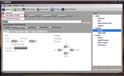

As it turns out, the reason that HandBrake confused me, is because it was too simple. Instead of pointing it at the first .99GB vob file, you just point it at the entire folder containing the files. I would be very surprised if I ever attempted to use MeGUI again, because I'm a sucker for simple.

I admit that I didn't read any instructions, but just followed my nose. I opened the program, selected the source (the first .99GB .vob), selected the destination, selected the file type, and pressed the Start button. After ~35 minutes, I had a mkv file that worked perfectly...except that it only contained the first .99GB vob, not the rest of them as I had hoped.
Obviously, I didn't select the source properly, but am not sure how to do so. Any help?
While selecting the source, you may select this : (see the snip)
to encode the entire movie at once . Otherwise, you may encode the entire DVD, too .
