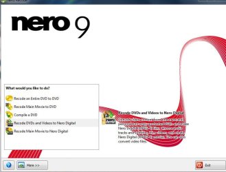

I honestly forget how its laid out, as I have Version 9 which chnaged the StartSmart layout a bit.
You may also find it in the Start Menu, in the Nero Folder.
In the Start Menu / Nero Folder/ its called Nero Recode.
My version is slightly different, but should look similar to this snip. You want the Recoded DVDs and Videos to Nero Digital, if you are wanting to create a MP4 file. Or the recode main movie to Nero Digital.
The only thing Im not sure if DVDFab can decrypt the disc on the fly like AnyDVD does.
So you may still need to decrypt it and rip the entire disc to your HD, then point Nero to that folder. It will see it as a DVD, but can not convert CopyProtected material.

Recode is not listed on the menu button at the bottom left corner. Now that I think of it, what I have is OEM...maybe it wasn't included.
EDIT: I'm not certain that it is exactly what you mean, but DVDFab does have decryption capability. It lists a number of ways that it decrypts each DVD, but I'm not sure that it is complete.
Ah .. You may have what they call the light or essential version,. which is basically the Burning utility only.
I was refering to its Copy part. CopyEntire Disc or Copy main Movie to HD. Im fairly sure this part is free isn't it?
I know it decrypts the files and writes them to the HD, but I was unsure if it actually decrypts in real time, as say AnyDVD will do.
Meaning, you can't just have it running and use another program to copy or convert the disc. You need to copy the disc the HD first to have it decrypted.
This was my understanding of it, so I very well may be wrong. Please correct me if so.

No, the only things missing in what I have in DVDFab are a couple of Blu Ray functions, for DVD it is complete. The DVD Copy portion is not free, but I have it, only I have not used it yet, only the ripper part. Therefore, I don't know what decryption function exist in the DVD Copy module.
EDIT: Disregard what I said, I got my wires crossed and thought you were speaking of DVDFab, not Nero Recode.
