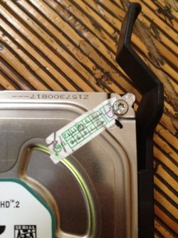

Built the PC myself, and as you can see on the pic below, the reseller warranty is ripped.

I would still call Seagate on Monday and see what they say.
You didn`t take it apart did you ?

Of course I didn't (but I tried though), but as u see in my previous photo, the HDD and all the parts in it are still intact.
