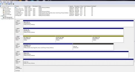

Jumanji, thanks! It was late last night and I misstated the program I was using. It is Paragon Hard Disk Manager 15. I'm posting the Paragon and Disk Management captures. Thank you.

Jumanji, This is very weird. After posting the screen shot of the Computer - Disk Mgt screen I noticed that it did not show that the Touro had a drive letter. I had assigned it one in Paragon but it did not show up in Windows Disk Mgt. I then went back to Win Disk Mgt and assigned the letter N: to it there. And now, all of a sudden, it shows up in Explorer.
I don't know what to make of that. Does Paragon Hard Disk Manager not work in the way it's supposed to? Or is this some random thing?

After posting my problem, and the images, and after rebooting, I went back to Disc Mgt and saw that it had no drive letter. So, within Disc Mgt I assigned it the same drive letter it always had, and now it shows up in Explorer and I have backed up my files.
So, now I don't know whether this is a disk specific problem or a Paragon problem.

Looking at the Disk Management screenshot, I feel its so much disorganised and needs to be organised better. But I would leave it to more proficient hands here.

You should use Disk Mgmt for the functions it can provide as it is safest, e.g. shrink from right, assign drive letter, etc. All other disk managers except Partition Wizard bootable CD can and will fail with data loss. This is based on helping with tens of thousands of complicated partition operations here, while no other website would consider doing even one.
You have a Dynamic disk which is meant to span a single partition over multiple hard drives. Is there? If not then you'll need to Convert a Dynamic Disk to a Basic Disk

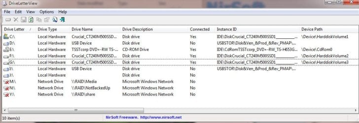

Sure sounds like a drive letter conflict problem (which is one of the things that DriveCleanup tool helps fix). Though not sure why it keeps coming back since "N" seems far enough away from your other drive letters to avoid conflict (is why m256997683119 suggested "Z")
This might help shed more information. Run the DriveLetterView tool. When everything is working, click Ctl-A to select all items in the display, Ctl-S to save. Before you actually save the file use the Save As pull down menu to save the file as Tab Delimited Text. Upload the txt file. Next time problem occurs, create and upload another report so i can compare.
Drive letters are assigned to disk volumes and mapped network drives. Windows remembers drive letter assignment to a device when its removed. (Letter isn't released until the device driver is uninstalled, not device simply removed) - or you manually change the letter. So letter conflicts can occur when different USB disk/flash are un-plugged / re-plugged
So maybe <fingers crossed> the tool might help reveal something
