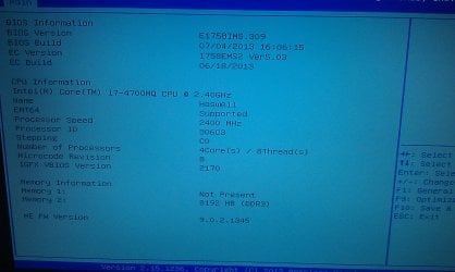

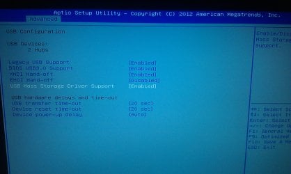

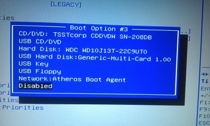

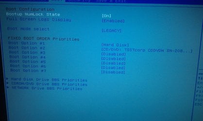

I'll also provide pictures of my BIOS in attachments. You can see the settings and all boot devices.

I don't see where either Legacy BIOS or CSM are enabled, just Legacy Boot - is there a panel not shown? But that may be enough to Bypass UEFI to Install WIn7 if that's what worked for install.

But I can still select a boot device to:
Hard Disk: WDC WD10J13T-22C9UTO and
USB Hard Disk:Generic-Multi-Card 1.00
I think it's dead, am I right? Should I contact MSI?

As you have Haswell CPU, you a UEFI/BIOS firmware.
Your screenshot one.
I'm afraid that I don't have option to enable Legacy BIOS or CSM...
Your screenshot four.
Did you install Windows 7 x64 in UEFI mode?
I would say YES, use your warranty.
ME/XP/Vista/Win7
You would know if you installed WIn7 in UEFI mode because you'd have had to choose the DVD as a UEFI Boot DVD device. I don't see that in your screenshots. Have you seen that and made that choice at all?
The Legacy Boot option on Screenshot 4 detected by Theog may be the only setting for this and it is set correctly to Bypass UEFI to Install WIn7
