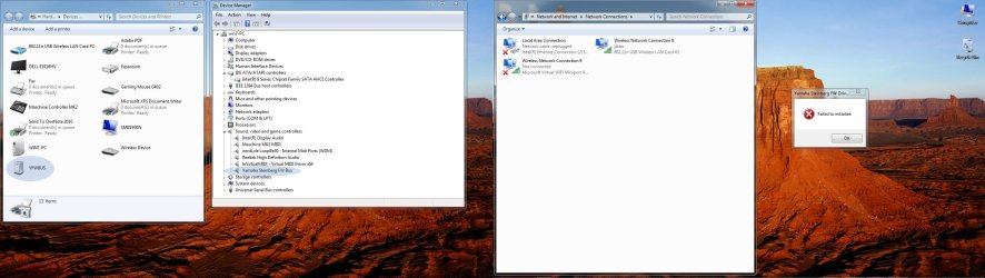

About the 1394 adapter, it does show as OK in Device Manager, and actually has never shown up in Network Connections even when the soundcard used to working. Attached is a screenshot of Device Manager, Devices and Printer, Network Connections and the error if that help you narrow down what the issue might be. Things have always looked like this in all the three places.
Don't understand what am I doing wrong.
