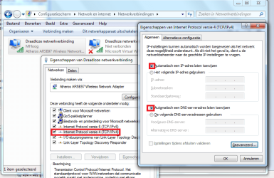

DHCP is not enabled on wireless!!
Set wired and wireless adapter properties to automatic!! network centre->change adapter settings. then right-click on adapter->properties->double click on tcp/ipv4
Do it for both wired and wireless. Off course you have to click OK multiple times to save it. Reboot afterwards
ACER ASPIRE 5742G
Acer Aspire 5742G
4,00 GB
WDC WD5000BEVT-22ZAT0
Most important is to set tcp/ip to "automatic get tcp/ip" address or something like that. A fixed ip-address is meant for servers. And wireless should never have a fixed ip address!!
And DON'T fill in DNS-servers. They are set automatically using dhcp (Dynamic Host Configuration Protocol)
ACER ASPIRE 5742G
Acer Aspire 5742G
4,00 GB
See attachment (in Dutch)
