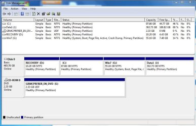

Hi! I have a Gateway PC that came with Vista installed on the C drive. The D drive (same disk different partition) contains the Recovery area from Gateway. I bought Win 7 Pro and installed into a new partition of the same drive (G drive). The rest of the disk was partitioned as a data volume (drive J).

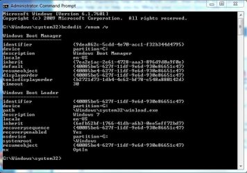

While I was moving from Vista to Win 7, I was using the dual boot feature from the Win 7 install. I have since deleted the Vista option in msconfig under the boot tab. (maybe that was not the first step I should have taken?)
So, now I want to get rid of Vista and maximize the use of the drive. What is the best way to get rid of the extra OS partition without reinstalling Win 7? Can I format C and run a Win 7 repair to recreate the MBR on G?
Is the Recovery volume that was delivered with Vista of any use? should I recover the space or would Win 7 take advantage of it?
Ultimately, I only want Windows 7 on here and the existing data partition on here. Can I combine the dead space(s) once vista is completely removed?
In the end, I want to make room on this disk to install (dual boot) Ubuntu Studio 64 bit. Would it be better to dualboot win 7 and ubuntu from ubuntu's dual boot process? Or Win 7's dual boot process (or is that not possible)?
Thanks!

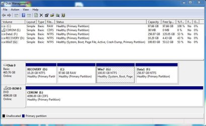

I went ahead and added the unallocated space to the data volume.
I was reading another tutorial regarding changing the "active" partition from Win vista to Win 7. Looks similar to my setup - vista and 7 on the same drive, two different partitions, the vista partition having system and active attributes. If I right-click the Win 7 partition, I do not have the option to Mark as active. Not that it is greyed out (like when I right -click the vista partition that is already the active volume), but the option is not listed in the right-click menu...

Hello crodgers, welcome to Seven Forums!
Geez mate do you have a mess.
The Windows "System" boot files will not function from the Extended partition / Logical drive that Windows 7 is no.
You are correct about having to (re)create the boot files to another location, also the fact that there can be no more than 4 partitions on a single HDD using the MBR system makes this more difficult.
The easiest way would be, so you don't have to disconnect any HDDs so this will work, is to create a Windows "System Reserved" partition to the first position on the HDD that is Disk 0 and make that the "System Active" partition.
Have a look at Option Three of this first tutorial linked below to see how to shrink the left side of the first partition on Disk 0 to create the unallocated space needed to create the partition, it only needs to be about 200MB to work.
Once you have unallocated space use Windows disk management to create the partition and mark it Active (do not give it a drive letter) then run the 3 separate startup repairs to (re)create the "System" boot files to the new "System Reserved" then you will be able to easily remove the Vista partition.
I'm sure you will get all sorts of suggestions here but I think this would be the easiest but you know what's said about opinions; ;) and be sure to post back with any further questions you may have and to keep us informed.

OK, so I started reading that Partition Wizard link before you posted and managed to change G to Primary, then set it to active. That got me to missing the mbr. I had PW rebuild mbr, then let the Win 7 CD repair - ended up repairing twice (disconnected other drive cables). It recovered the dual boot of vista and win 7. I removed the Vista boot option in the system config window, boot tab.
So, now I am closer to where I need to be, I believe. looking at my configs, it looks like I have the MBR on G with Win 7.
Now I can format the C partition and expand G to the left, correct?
Is there any need to have J as a primary? Should I change that to a logical?

crodgers,
Format the C.
Use Partition Wizard to extend the G to the left (disk management doesn't extend to the left).
Leave the J as a primary partition.
