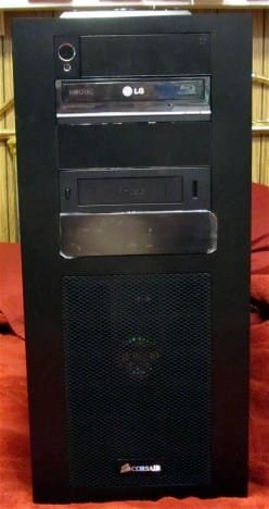

Here is a shot of the case with the front panel, filter, and devices installed. I haven't removed the protective film on the ODD and the drawer and won't for now. The ODD and the drawer are pretty shiny and I'm considering taking some really fine sandpaper to them to kill some of that shine and duplicate the brushed aluminum finish of the case front panel.
Here is what the front looks like without the front filter.

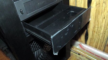

I almost forgot to take a picture of the drawer and I had already lugged the case to hallway where I've been stashing it when not working on it (it's a shorter distance to lug that boat anchor) so I snapped a quick pic from there.

Thanks, Gary! I saw that drawer online several years ago and have been lusting for it ever since but never had had an empty 5.25" bay to put one in until now. Stupid as it sounds, I'm almost giddy over it. It's pretty slick; just push on the front to open it and push again to latch it.

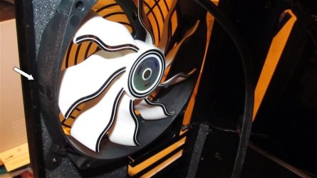

I ran into another problem when I tried to install the side panel; it wouldn't fit. The stiffening brace to keep the panel from flexing was hitting the 140mm rear fan. I tried to flatten it out but it wouldn't bend the way I wanted so I cut it out and covered the area under it with more acoustic foam (easier than painting). It now fits.
The offending fan. The arrow points at the part of the fan that was interfering with the case side brace.

The fans themselves aren't the problem; it was the fan power hub, the doohickey I plug the side fans into. The fan I broke was a fluke; I hadn't modified the ears.

I took all the panels (Front, Top, Sides off my Phanteks case looking for dust holes and found some. I could follow the little dust bunny tracks.
The two front fans were horrible. About 1/3 of the air the fans were drawing in was going around the filter not through it. Corrected.
Found some vents on the back that were drawing unfiltered air in instead of exhausting. I believe that was cause by the 6 radiator fans drawing the air in. Corrected.
