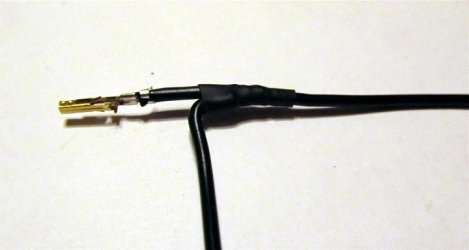

I tackled the Siamese hot swap bay SATA power cables today. I started by crimping the ATX pins on the ends of some #18 wire I had knocking about. I went with #18 since there will be only two HDDs at most on this cable so I didn't need to worry about excessive voltage drop although I did split the cable to make sure I didn't have any dropouts when plugging in a second HDD; I also didn't feel like fighting with crimping the pins. I then stripped 1/4" of insulation from the wire a little ways from the pin and spliced a second wire to the first, then soldered the connection.
After that, I shrunk a heat shrink sleeve over the splice...

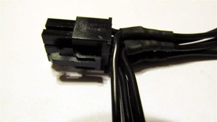

...then plugged the pins into the PSU connector. That actually worked out cleaner than what I expected, despite the crowding.

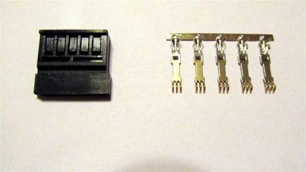

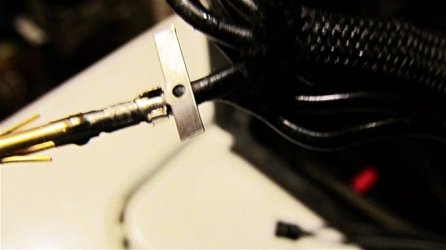

After cutting the wires to length and slipping some sleeving and heat shrinks over each bunch of wires (five in each bunch), I crimped the SATA power connector pins on the ends of each bunch of wires (ten pins total) and plugged the pins into SATA power connector bodies (two). Here are what the pins and connector bodies look like.
The first five pins crimped just fine but I couldn't break off the little "tree" they come on. I normally cut the "tree" and leave a bit of it attached to the end of the pin to give my fat, little fingers something to hang onto when I'm crimping the pin. This an example of what I'm talking about from when I built my current case.
Normally, all I have to do is just bend the tree back and forth a few times and it will break right off, which is what happened after I crimped the five ATX pins. Not with these miserable, misbegotten, malevolent pins. I had to cut the bloody things off and it was a bugger getting in there to cut them, even with the tiny dikes I have. On the second cable, I had trouble crimping the first two pins to the insulation. I have no idea why; the remaining three crimped just fine and dandy. At least the problem crimps held up to the pull test. After inserting the pins into the connector bodies, I stretched the sleeving out and shrunk the heat shrink sleeves on the ends. I also used some brush on Krazyglue to make sure everything stayed put (I like that stuff; it's much better than the nail glue I've been using).
