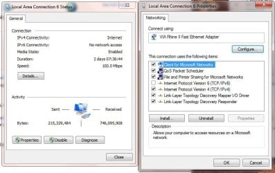

Do you have IPv6 unchecked in you Lan network connection ?
No its checked
