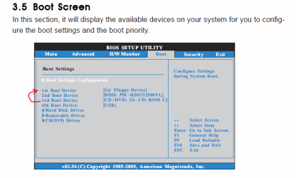

The operating system (any operating system) will never have any effect on the BIOS or your ability to get into the BIOS settings. The BIOS is loaded and runs it's startup routine before the hard drive is detected, which must be performed before the OS is started.
If the BIOS cannot complete it's startup routine it will end in a failure and the hard drive will not be booted at all.
Below are some snips from your ASROCK manual.
Resist the temptation to make any changes in your BIOS, other than changing the boot order, unless you absolutely know what the change will do!
You've got to be pressing that F2 key repeatedly just after you press the power button - or just as anything appears on the screen.

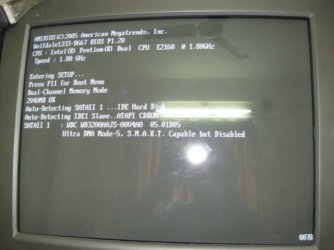

To -TVeblen and all friends,
I am posting screenshot of my PC for clarification of my issue. There you can see that I have pressed F2 button to enter into Bios but i am unable to do that as booting process stopped after detecting my WD SATA hard disk.
But if i remove my harddisk then i can enter bios as normally.
If you need more details then please tell me.

Ah, I see now.
Well, you can disconnect the hard drive to get into the BIOS settings and change the boot order to boot from CD first, but if the hard drive crashes the BIOS then I don't see how you could run any diagnostics.
