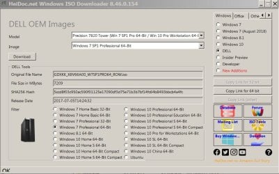

the dell
GDXKK_X8V66A00_W7SP1PRO64_ROW.iso
is a bit more recent than
G13K9_PW4KGA00_W7SP1PRO64_ROW(DL).iso
You probably need to use the usb2 port to install from either of them. Or split it onto 2 dvds.

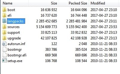

If doing the dvd split thing, delete the language packs if not needed. Default is en-US.

From HeiDoc tool - https://www.heidoc.net/php/Windows-ISO-Downloader.exe
To make a Win 7 USB boot able drive (8G minimum):

On Win 7 use 7Zip to extract all files and folders from the Win 7 iso file to a folder on your drive.
Sources\install.wim is bigger than 4 G, You have to split it into two smaller Install.swm files
Download View attachment Split_Wim.zip
Extract the Split_Wim folder
Move the Install.wim from \sorces folder to Split_Wim folder and run the Split.cmd
When done, delete Install.wim and Move the install.swm files to the \sorces folder.
Finally copy all files and folders to the USB drive you prepared like above.
