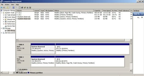

I am running Windows 7 Ultimate. I have two hard drives in my desktop. I accidentally renamed the "System Reserved" partition on my main C drive. As soon as I realised, I quickly renamed it back - so I am hoping that I haven't lost any files.
However, when I looked at status of the "System Reserved" partition in Computer Management, it shows "Healthy (Active, Primary Partition)" instead of "Healthy (System, Active, Primary Partition)" - the word "System" is missing. Can anyone tell my why this might be, and how this could be rectified (if indeed it needs to be rectified)?
I have several "restore points" that I can use, but wasn't sure if that would solve the issue (need advice first).
I am a bit scared to turn my computer off, so any help would be appreciated.

Hi
C: drive is running Windows 7 at the moment. How can I check if C: partition set as System? Thanks

Use Disk manager (C:\Windows\System32\diskmgmt.msc).
How did you renamed the System partition and saw Healthy (Active, Primary Partition) ?

I went into "Computer Management". I saw the two internal drives that have (C: & E:), and right clicked on the wrong partition - which was the System Reserved partition of the C: drive (instead of the E: drive). I assigned a letter to this partition (H:), then opened the the folder to explore this drive. From there I right clicked on the H: drive and renamed it. I didn't make any changed to this partition other than to rename it. I quickly named it back to "System Reserved" when I realised my mistake.
I saw Healthy (Active, Primary Partition) in "Computer Management" after I had renamed back to System Reserved

Hi iko22
Reading through the information on the link you sent, I wonder if my problem lies in the fact the my E: drive is showing Healthy (System, Active, Primary Partition)? The "System" part of this is appearing on the E: drive and not the C: drive. Is it possible the "Systems" has been writing to the wrong drive? Please see attached screenshot.
My Windows 7 Ultimate computer was obtained with just one drive installed (C:). I installed the E: drive and put Windows 10 on it. However, Windows 10 crashed and is unrepairable, so I am back using Windows 7.
For the time being, I am just intending to use the E: drive for storage and was attempting to reformat it when my issue came about.
Well, it's probably not so much a "problem" as merely an unintended configuration.
It looks like you installed a blank, new disk for Win10 and let the Win10 installer reconfigure your system, which it did by abandoning the original "System Reserved" partition and creating a second SRP on the new disk. That would imply the original SRP (on the 500GB disk) is still functional, and you just need to tell the BIOS to start booting from it again.
Since you originally started with just the 500GB disk, you should be able to disconnect the 1TB disk, plug the 500GB disk back into the first port, and Win7 should boot up like it originally did. Its SRP should be annotated "System, Active", just as you want.
If that works, you can plug the 1TB disk into the second port and it should not interfere with the 500GB SRP still being "System, Active". You should then be able to remove both 1TB partitions, recreate a single large partition, and use it for your data.
There are shortcuts that leave both drives connected the whole time, but you may find it clearer to follow what's happening if you temporarily disconnect the 1TB disk while you sort out the 500GB bootup.

No it is not a branded computer, it was put together by an IT expert. With a legitimate copy of Windows 7 Ultimate loaded. (I still have the disk)

Thank you for your reply. What you are saying makes sense, but when you state "Since you originally started with just the 500GB disk, you should be able to disconnect the 1TB disk, plug the 500GB disk back into the first port, and Win7 should boot up like it originally did" could you please explain what you mean by "first port"? Are you referring to the SATA connections on the motherboard?
I honestly can't remember what I did when I installed the additional 1TB drive, but it's quite possible that I had to use SATA extension (male to female adapters) and move SATA cables on the mother board (I can't remember what to where though).
Yes, I'm talking about the SATA jacks on the motherboard. (I've deliberately avoided using the terms SATA0, SATA1, etc., because it can be misconstrued depending on context, and different devices/utilities may start counting from either 0 or 1, adding to the confusion.)
Let's call them jack-x and jack-y on the motherboard, where jack-x is currently connected to your 1TB disk and jack-y to the 500GB disk. Your BIOS is evidently set to boot first from jack-x, which is why it's using the SRP on the 1TB instead of the SRP on the 500.
Shut down, disconnect both SATA data cables at the motherboard end, plug the 500's cable into jack-x, and leave the 1TB cable dangling. Power on, and see if the 500 boots by itself like it used to do. If my guess is right, the Win10 install didn't mess with the 500's SRP, so it should still work. (And if it works, your problems creating the system repair disk will be moot.) You can leave the power cables (the larger of the two connectors to each hard drive) connected, just disconnect/switch the data cables.
If the 500 works by itself, shut down again, plug the 1TB cable into jack-y, and boot back up. Check in Disk Mgmt to make sure the 500's SRP is still "System". You should be able to take it from there.
If it doesn't work with only the 500 connected, you'll need to repair the 500's SRP. There are lots of ways to do that, so let us know and you'll probably get several different suggestions, one of which may be easier for you to execute than others.
