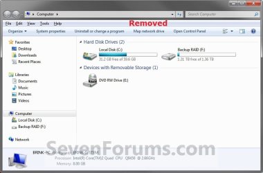

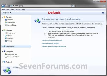

EXAMPLE: Homegroup in Navigation Pane
NOTE: This is Homegroup added (default) (left screenshot below) and removed (right screenshot below) from the Navigation Pane.

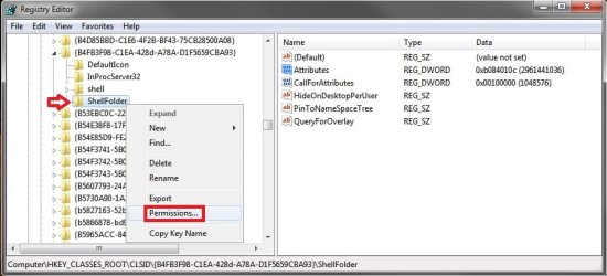

3. In Regedit, go to the location below: (See screenshot below step 4)
HKEY_CLASSES_ROOT\CLSID\{B4FB3F98-C1EA-428d-A78A-D1F5659CBA93}\ShellFolder
4. In the left pane of regedit, right click on the ShellFolder key and click on Permissions. (See screenshot below)

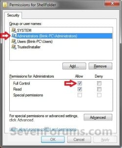

5. At the top, select the Administrators group. At the bottom, check the Allow box to the right of Full Control and click on OK. (See screenshot below)
6. In the right pane of regedit, right click on Attributes and click on Modify. (See screenshot below)
