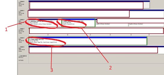

here's the drive setup (i have quite a few disks in the workstation -- 6 physical -- so i only kept the relevant [partitions] in the screen capture).
#1 shows the original [xp] system partition where I suspect the MBR is located (because it is 'active' -?). I would eventually like to delete this partition (while keeping & booting off #3)
#2 shows the partition win7 were originally installed on (before flipping them over to #3, an Intel SSD drive). Again, I would like to eventually delete this partition as it's been rendered redundant.
#3 is the OS I am currently using, and the disk/partition I'd like to hold the MBR, becoming the system (and 'active' -?) drive.

theog is right. Your C partition is logical. You have to first make that primary. Sorry I overlooked that.
Your current active partition is 'Y'. It contains the bootmgrs for both XP and Windows 7. They will both be copied. But that is not a problem because in the process the C partition will be activated. You only have to change the BIOS boot sequence to boot from the SSD.
