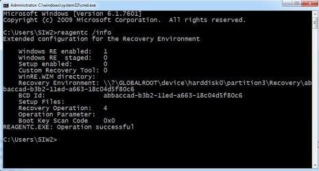

you had better check that winre is enabled and where it should be.
reagentc /info
if it is not enabled, try:
reagentc /enable
- - - Updated - - -
If winre has gone missing, it can easily be replaced from the installation media or by using a custom bootable wim file.

It is enabled - I just saw the exact same stuff you posted

have a look and make sure winre.wim is where indicated

I just searched the directory C:\Windows and the file winre.wim is not to be found. Also, there is nothing shown for 'Recovery environment' when I do reagentc /info.
