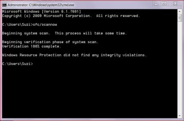

I have been researching to try to determine what has caused these issues and have not found a solution. I thought maybe a "restore" to an earlier time before all these issues began might help so I ran a restore back to 7-16-11. It worked, however my issues were not corrected. I also ran an sfc/scannow on my C drive to see if there were any corrupt files on it as well, but it all came out clean. I also ran a full scan to be sure I did not have a virus of some sort and it came out clean as well.

2. Do I need to run the Lifeguard Diag. short test on my External HD? I previously ran the sfc/scannow thru an elevated command prompt and I was not sure if it actually just checked my C: drive or all of my drives. Is there a way for me to run sfc/scannow on my E: external drive? Any other suggestions to help diagnose my external drive? Good news is, I have not seen a NTFS error yet today. Keeping my fingers cross. :p
