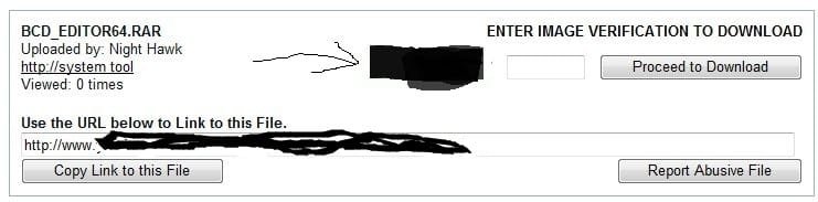

Since I couldn't relocate the site that carried both the 32bit and 64bit versions of the BCD Editor I uploaded the 64bit to a free file sharing host. YourFileHost.com - Free hosting for ALL your files -S
The screenshots for the 32bit version however still show how that works. System Tools - BCD Editor
Once 7 is up and running you simply double click on the BCD Editor file itself. Once you highlight the preversion version entry click on the "set description" button to rename that to Windows XP. Meanwhile I'll test the link here to see how that went.
You have to enter whatever characters are seen in the small box and then click the download button. Ignore the ads and other lame stuff on the page once you get there! :rolleyes:
