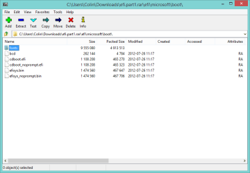

Just a fyi for ya; those 2 files you posted cant be opened as it says they are password protected.
No they aren't....they are fine.

This is the message i keep getting when trying to open the file:
"Enter the password to open the file".

They open fine for me. What unzipping tool are you using?

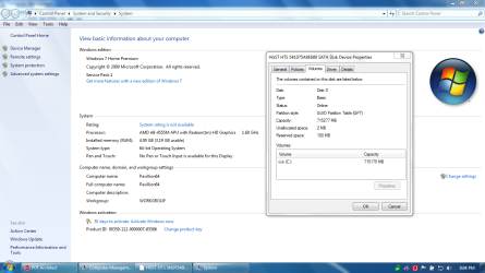

Thanks for your sharing! I've searched all over the net for numerous Win7 UEFI USB boot install guides, but all those steps & tricks result in Starting Windows splash animation freeze problem for me. Yours is the only one I get to that describes how to work around the problem. Unfortunately, this still doesn't work for me.
My HW is Acer E1-572G laptop preloaded with Win8. I'd like to preserve the original GPT partitioned disk esp. those system & recovery partitions so I want to install a fresh Win7 via UEFI USB boot. No luck!
Any further advise or pointer to anything that might solve this issue. I swear I've read & tried like 10 different step-by-step guides around the net but still get Start Windows splash freezes.

Yes, I know this post is kind of old. In any case, inside the E:\efi\microsoft\boot folder on the Windows 8.1 install media, there resides another folder called resources, ie; E:\efi\microsoft\boot\resources and in that folder, there is bootres.dll
I checked and it is both on my installed system of Windows 7 X64 and within the install.wim on the install media for Windows 7 X64. The E:\efi\boot should only contain bootx64.efi and nothing else. I am about to recreate my install media on my HP USB drive with the new changes made and will report back once I have and definative answer as to the functionality of my media.
Please give me at least one to two hours.
EDIT: OK, still fails. There has to be something in the Windows 8.1 install media that is missing in the Windows 7 media. Maybe there is some type of key signing verification that is missing and freezes the install. Will have to fine tooth comb through the media and find the diff.

I was able to get a proper UEFI Install for Windows 7 Home Premium. I used the BOOTX64.EFI from Windows Automated Installation Kit Supplement for Windows 7 SP1 iso. Immediately booted into UEFI install. There is the lack of USB 3 support. There is no secure boot either. Admittedly, while installing drivers, I got the BSOD and was unable to recover. However, I am reading up on some partitioning scripting to create all of the proper and recommended partitions, including WinRE and recovery. Also, I need to add my drivers and such into my install.wim. Any recommendations as far as free wim editors?
Window 7 Home Premium / Ultimate X64AMD Quad-Core A8-4555M APU4GB DDR3L SDRAMAMD Radeon HD 7600G Discrete-Class
HP Pavillion 15-N211DX
HP
4GB DDR3L SDRAM
SATA 750GB 5400RPM
COMODO
Cyberfox X64 for AMD
Standard 7 Home Premium 64-bit ISO (Media Refresh), burned to DVD, went into my UEFI setup. Using HP Pavillion 15 N-211DX Laptop. Disabled secure boot, enabled USB compat, removed all my signing keys, saved config and shutdown. Upon boot, I did F9 to select what to boot from. My UEFI config gave me the option to boot from UEFI HD, UEFI DVDrom or Standard hard drive, Standard DVDrom. I chose UEFI DVDrom, let it load and went into the partitioning section. Did Shift;F10 to get command terminal. Ran notepad and opened my log to be sure I was in UEFI and was. Ran the install and am now fairly up to date with most drivers, except 1 that HP does not provide for Windows 7.
6112569448151638194
