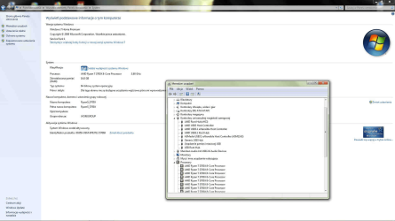

Yes, that is exactly what I want. I have read around the internet that people have had success. There is even some custom drivers that exist now for the USB controller that is on the CPU. Or to use the Asmedia one on the motherboard (I'm not sure how that works yet).
I have a 3700X. But getting from here (a box of parts and a bunch of empty USB flash drives) to that screenshot might take a few weeks and a lot of reading and troubleshooting. One step at a time I guess. Would you advise doing a custom full Windows 7 installation in advance, is there already one available? Or to do a basic installation.. update manually.. and then make a integrated Windows installer later on?
Yes, that is wnat I linked in my previous post - canonkong made them
