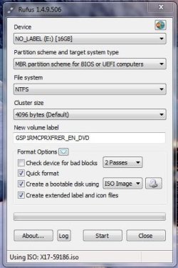

Here is a screen shot of my settings and I added the ISO image from X17-59186.iso which I ordered from AtomNik. I will try this again this evening.

PS -- I just realized (again) that when I attach the iso file, Rufus changes the Partition scheme to MBR and the file system to NTFS. Which one will work? I don't necessarily care about UEFI anymore. Too much hassle. Windows 8 annoys me more than anything.

Right, my only point is that I went from top to bottom, set the Partition scheme and target system type to GPT partition scheme for UEFI computer, the File System to FAT32 (Default), Cluster size to 4096, and New Volume label to "Win7 Install"
***AFTER DOING THAT*** I selected the iso and RUFUS change the settings back to the screen shot, **NOT ME***,,which I noticed before when I first started down this path. In the spirit of "programmers code things to protect users from themselves", I thought perhaps it meant that I had to use MBT and that's why the software changed the combo-boxes.

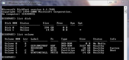

I had done that also. Window 8 gave me a "permission denied" even when running as administrator. However, it appeared to clean the disk.
Rufus ran successfully using all the settings provided and this is what my disk part looks like. It does show as a GPT, which I think may have been my problem the first time.

here is the screenshot

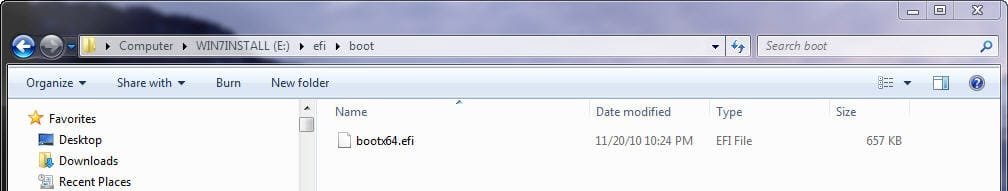

furthermore
It looks like RUFUS made the bootx64 in the correct directory so I believe this may have a chance to work. Other documentation had users manually move and rename a file after doing OPTION #2 in this forum (not using RUFUS(. I did that, but I might have fouled something else up along the way.
That's the way Rufus works unfortunately. I ran into the same problem. Set everything up, top to bottom but when I browsed to select the iso file it changed from UEFI/GPT back to MBR so I had to change that again after selecting the iso file.

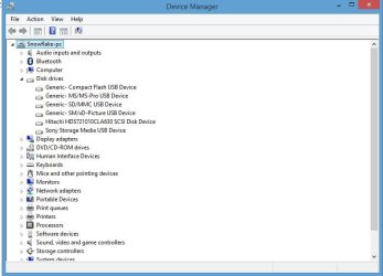

I probably have something fouled up because I don't fully understand this process. Right now, I have Window 8.1 on what I assume is a UEFI, gpt, NFS Partition on my hard drive. I attempted first to install Windows 7 x64 from a DVD and I got an error that a required driver could not be installed. No other information. That created a new partition so when the Windows Boot Manager loads I have a choice (Screenshot A) the setup version or Windows 8.1.
I have what I believe is now a bootable USB with Windows 7 x64.
I have been reluctant to touch the HDD because a while back, on a laptop, I lost everything learning about dual boots, swap space, and Ubuntu.
Back on the current PC, I noticed now that the Hitachi Hard Drive does not show up in the Boot Sources, where as it did before. The DISKPART command also hangs on this PC. Something must be fouled up.
Since I basically consider Windows 8.1 useless, and I have recovery disks on hand, I will try to reformat the Hard Drive and get the driver, if I need it, next. I'll take a look at disk clean, but I'm not sure how to use it at this point.
I've attached several screenshots. The BIOS utility from HP seems to have limited options compared to others I've seen. Again, I really appreciate your help. Maybe I'll come out of this exercise as a hardware guy, but I doubt it. :o
