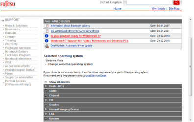

Try here:
support downloads Fujitsu
ME/XP/Vista/Win7
Thanks for answer. Fujitsu Siemens doesn't provide any drivers for the PCI Memory Controller for O/S win7(64bit). I was wondering if anyone found another solution.
