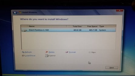

I have had nothing but trouble trying to install onto an SSD for the first time. I bought a Samsung 840 EVO 500 GB SSD, and have spent most of the day troubleshooting. I'm pretty sure it's a Windows Vs Samsung compatibility problem.
Issue #1 - Can't format. Error code 0x80070057.
So many people all over the internet have had this error. Nobody's posted a solution that worked for me. Many on this forum recommend Diskpart and formatting the SSD prior to installation. This didn't work. I successfully created the partition, but formatting it results in an I/O error which I couldn't get past.
However - I read something about a success if formatting the drive was successful, in windows 7, and then doing the clean install. I did that with my new hardware - installed windows on the HDD instead of the SSD. I then found a utility called EASEUS Partition Manager, installed this, and successfully formatted the partition in Windows 7.
I deleted the partitions on the HDD, and attempted to reinstall. I got past this error, and got a new one.
Issue #2 - Expanding Files. Error code 0x800745D.
I found that Windows took Disk 0 (the HDD) and created that 100MB partition on it. It then threw this error. What's that about exactly - I would think the recovery partition would need to be part of the SSD. Shut down, disconnected the HDD, restarted the install DVD, at this point brings me back again to 0x8007057.
Suggestions appreciated. Thank you.

I am restarting the HDD windows install now, and will disconnect the HDD after formatting the SSD and see if that works.
Win 7 Ultimate x64
Believe I've tried everything in Post 2's linked articles.
Attempted to format the SSD with IDE enabled instead of AHCI. Yeah, that didn't work at all.
Successfully installed windows again, on the HDD. Haven't been able to format the SSD successfully this time. What tempermental hardware, I think I'll be satisfied just to use it as a disk - I found out tonight I cannot send it back :( .

No. Windows is giving an error when I try to format/partition it.

I hesitate because one time, I did manage to get a functioning drive formatted. Then, I tried to install windows on it, after deleting all partitions on the HDD, got Issue #2, and now it's not behaving. That makes it sound like there's a software solution.

Thanks, I reread it all. Newegg will only replace it, no refund.
After trying a different software (Partition magic), then EaseUS again, I managed to get the SSD to a state that Windows would format it. I have formatted it successfully as a 500GB drive and it works under windows. I really don't understand why it worked.
Did you unplug the HD during all steps in tutorial?
No. That might be what I did wrong before. Previous install was like this :
  1. Used EASEUS and formatted the SSD. Exited windows.
  2. Rebooted from DVD and started the Windows Installer
  3. Deleted partitions from the HDD via DISKPART
  4. Tried to install on SSD
I'm unsure about reinstalling on the SSD since I don't have a consistent solution for partitioning and formatting the thing.
Are there UEFI settings in BIOS setup for UEFI, CSM, Legacy BIOS or EFI items in the boot order?
Yes.
CSM is enabled. The DVD drive doesn't work without it.
Boot order is :
P1 ASUS DRW-24
P3 WDC WD 2003 (HDD)
SSD does not appear there.

New Egg is not the manufacturer. If they will replace it then I would do that first. Or you can call the manufacturer's tech support to have them help you test it, update firmware, or see if this is a known issue they can resolve. If not allowing them to RMA is another option.
The correct way to install an OS is to delete, create and format the partitions during install during Steps 7/8 of Clean Install Windows 7.
Are you booting the installer as an EFI device or installing to Legacy BIOS? What are the exact settings choices for CSM? Is there a setting for UEFI or Legacy boot first?
The tutorial says clearly that all other drives are to be unplugged during install. What else did you skip? The skipped step is often the fix.
From that guide, maybe I should follow 186875 guide for UEFI devices.
This is ASUS UEFI BIOS Utility.
Under boot, I have a CSM subsection with these choices
Launch CSM (* Enabled, Auto, Disabled)
Boot Device Control (*UEFI and Legacy OPROM, Legacy OPROM only, UEFI only)
Boot from Network Devices (*Legacy OPROM first, UEFI Driver first, ignore)
Boot from storage devices (*Legacy OPROM first, UEFI Driver first, ignore, Both-Legacy OPROM first, Both-UEFI First)
Boot from PCI-E (*Legacy OPROM first, UEFI driver first)

Thanks for the idea. Ubuntu installed from a Live USB with no problem, and Gparted formatted the SSD without a hiccup. Trying to install, again, on the SSD produced the same error shown previously - even with HDD physically disconnected. So this confirms the problem is a Windows conflict.
But I'm giving up, I'll just use the HDD as a boot device. I now have a Ubuntu install on the SSD, and can use the SSD for whatever else needs fast loading. Thank you all for the help.

You can try an EFI install by booting the installer as an EFI device, delete all partitions again during install, create and format new.
Your BIOS settings appear to allow either EFI or Legacy installs.
