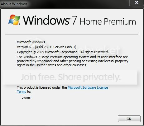

How do I know which one I'll need? I have Windows 7 SP1 Home Premium on my laptop right now.

What version did you have on your pc ?
I don't know? It just says Windows 7 SP1, but I had never heard of a media refresh vs "old".
Here's the info:

Yes, but is it media refresh or "old" SP1? According to gregrocker, it seems I'd want the "media refresh" version of the ISO.
Oh, I just took a photo of the sticker from under my laptop because it's easier to see the product key when I'm going to do the reinstall instead of digging under the computer. It's a bit heavy for a laptop.

Also, when I go to the official Asus support site for my specific model, it gives me the following options under Network adapter:
Version: V8.0.0.238
Description: Azurewave Wireless Lan Driver and Application
Wireless Lan Driver and Application: Please first install the Wireless Console Utility before this driver installation << It won't let me do this because it says another version is installed?
1. Please refer to below FAQ to check your Wireless''s PID code:
http://support.asus.com/faq/asus-fa...A-AA97-0DD4-7E09-C7785177ACC0&SLanguage=en-us (I did this and mine are as follows)
sShowImage
2. This WLAN driver is for below PID code:
HardwareID=PCI\VEN_168C&DEV_002B
HardwareID2=PCI\VEN_168C&DEV_002A
HardwareID3=PCI\VEN_168C&DEV_0024
HardwareID4=PCI\VEN_168C&DEV_001C
File Size 664,1 (KBytes) 2009.10.23
___
Version: V8.0.0.197
Description: AW-NE785 Wireless Lan Driver and Application
AW-NE785 Wireless Lan Driver and Application for Win7 64 bit (Please first install the Wireless Console Utility before this driver installation)
File Size: 648,25 (KBytes) 2009.10.12 update
___
Version: V12.4.1.11
Description: Intel(R) 5300 WiFi Wireless LAN Driver
Intel(R) 5300 WiFi Wireless LAN Driver for Win7 64 bit
File Size: 2,72 (MBytes) 2009.09.08 update
___
Version: V8.0.0.144
Description: AW-NE771 Wireless Lan Driver and Application
AW-NE771 Wireless Lan Driver and Application for Win7 (Please first install the Wireless Console Utility before this driver installation)
File Size: 21,15 (MBytes) 2009.09.02 update
___
Version: V12.4.1.11
Description: Intel(R) 5100 WiFi Wireless LAN Driver
Intel(R) 5100 WiFi Wireless LAN Driver for Win7 64 bit
File Size: 2,72 (MBytes) 2009.09.02 update
Thank you.
Asus G72GX
Intel Core2 Duo P8700 @2.53GHz
6.00 GB RAM
