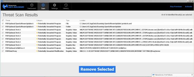

I took the battery out when it was running ;o, its just that is was plugged in. I have no idea what is going on, this has never happened to me before. Obviously League is taking most of the CPU up, but here's some screenshots of the processes. I'll also send a screenshot of the Malwarebytes scan.
Edit: MalwareBytes scan did not work. ;c

Malwarebytes did work you just didnt clear the errors, that bottom one looks really suspicious.
You also seem to be running a lot of services that "talk" to their servers all of the time(checking for updates) on my own system i set a lot of them to manual and check for updates weekly,
>> my rule of thumb if i dont use it daily set it to manual, ie skype Adobe etc. <<
I also see that youve had Mcafee at some time it has not been fully uninstalled
