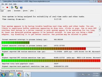

Hi All,
I've been having issues with latency after a recent build and fresh install of Win 7 Home Premium. When playing video (especially online) I see horizontal bars flash randomly on the video screen. I also hear audio crackles / cut outs when I'm playing music through Foobar and browsing the web - usually when navigating to a new page, opening a new tab, mousing over an auto-dropdown, these types of things.
I've been reading up on these issues, and have updated my Realtek drivers. I've been using a Rosewill wireless USB adapter for internet, but have noticed the same issues when connected directly to my modem as well. Only thing is, I don't see iusb3xhc.sys affecting latency any longer when I'm connected directly.
When I disable my LAN controller, I see the issue with ndis.sys disappear and it's not affecting my latency as reported by Latency Monitor.
When directly connected, I do still see ndis.sys coming up as a latency issue in Latency Monitor.
I have just uninstalled my Nvidia video drivers to see what effect it would have on the Latency Monitor finding dxgkrnl.sys being the King of latency-causing affairs on my troubled system. Now, this file is not causing issues.
So, now, being directly connected to my modem, with no video drivers installed, the issues come up as seen in my attachment. ACPI.sys and ndis.sys.
I'm at wit's end, what is my next step to get this fixed?
Thanks ahead of time for your assistance!

What is your power profile set to, is it high performance? In foobar when you listen do you use WASAPI or Directsound?

My power profile is indeed set to high performance, and all of my audio goes through my Creative Sound Blaster Z.
The video issue (horizontal stripes and stuttering) happens even when Foobar isn't running. I've also made sure my computer is set to 4 cores at boot, and set Vertical Sync to Adaptive in the Nvidia control panel.
I've disabled digital audio in the Nvidia Control Panel as well, and have done just about everything I can find to try and fix this issue but it makes watching Netflix, for example, relatively irritating.
I haven't noticed the issue, however, when playing CSGO or Civilization V.

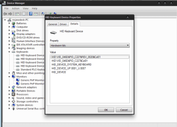

As far as in the Device Manager, the only anomalous thing is the driver that's lacking for "PCI Simple Communications Device," though all of my peripherals show up in Device Manager and are working properly.

Whats the hardware id for that device as shown below?

It's attached! Thanks.

yeah looks like chipset drivers what model is the board it self? Sounds like one of them is out of date and if it is will prob cause latency on its own to be honest. You should try safemode with networking and see if you get the tearing in that mode.
