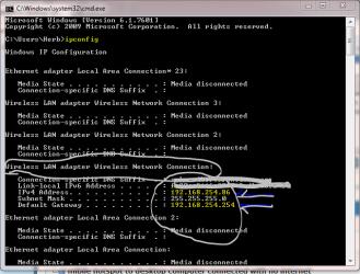

what I need to know is what if any your Ip address and default gateway are. What does your connection icon in your system tray show? I assumed you can see the hotspot and are able to at least connect it but cant get a valid ip address.

The ip address is 192 168 43 31 the subnet is 255 255 255 0 and the default gateway is 192 168 43 1

I take it the power down and usb switch up had no results? Please let me know what your adapter icon in your system tray shows. it should look like this if your able to see and connect to the hotspot. it will have yello shield over it if there is no internet access.

Looks like your connected to the hotspot and your ip matches your default. what result does a ping of 8.8.8.8 have?
