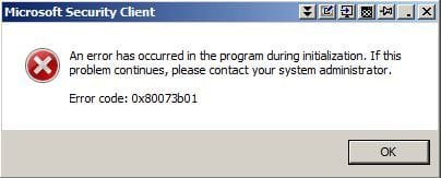

I'm having some problem about a week ago with Microsoft security essentials bugging out on me and not opening or updating. Basically the message I got on opening MSE was windows cannot access specified path or file. You may not have the appropriate permission to access the file. Upon reading this about a week ago, I think! I proceeded to foolishly downloading a Zeroroot access program and a few MSE alternatives. Since then I have still been unable to re-install MSE by deleting all components in the registry.
The error code I get with trying to re-install MSE is 0x80070643
Having then unistalled the zeroaccess program and the previous alternative antivirus programs, I still cannot get MSE working, and I now have a windows 7 update error. The new system update I believe may be to do with security as-well!! The error code on doing a windows 7 update is 80070005, and it did cut out at 9% every time. (although now I think it is just 0%)
Can someone please help me as I have had a very successful streak of avoiding viruses by always usin MSE. I don't want, and can't afford to get a virus attack, not to mention Im runnign windows 7 ultimate so I need the windows 7 updates too because the ultimate can be dodgy sometimes. Nb the update I cannot do is 1.4mb but I am anticipating windows will throw me a new update any day soon which could be anywhere from 30mb to 200mb and it could fail all of it leaving me prone to attacks.

ok done. nb:Got an error on each reboot about Microsoft security essentials error 0800ib3 something..(ignore4now)

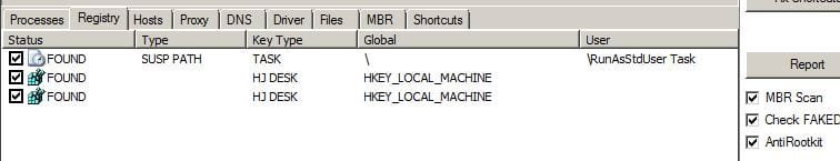

Restart the PC before you run RogueKiller
RogueKiller for 32bit <==== Download Link
RogueKiller for 64bit <==== Download Link
:ar: Click on one of the links above that goes with your Windows 7 bit versions
:ar: Save to the Desktop.
:ar: Close all windows and browsers
:ar: Right click on
and choose
:ar: Press: SCAN
:ar: provide the RKreport.txt (Mode: Scan) in your reply.

ok
I missed the rogue kill step and did the restorewindowsfirewall step first by careless mistake.

ok attached....should I run restorewin again??
Also should I delete these that came up in Rogue Killer? see attached

Run RogueKiller again and click on Delete .
