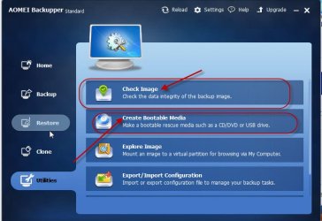

I would recommend the easy to use AOMEI Backupper. Free Download AOMEI Backupper Standard: Windows Backup & Cloning Software ( I have been using Paragon Hard Disk Manager Suite which I had purchased long back)
Once you reinstall Windows, do not update, do not activate. Do not install any programs except the backupper.
Copy a few files and folders to the system drive and take a backup. Then restore. Check that the backup works. In short do a trial and make sure you can backup right and restore works. ( I had always done it during the initial install)
Then do your updates and install the programs.When you have groomed your system right, then activate. ( You have 30 days to activate)
Always check image integrity after a backup.
Create a WinPE bootable media. ( I always prefer to do a backup and restore with the bootable media.)
If you are not happy with AOMEI Backupper, you can go for Macrium Reflect, which is most recommended here but I know nothing of it. :)
