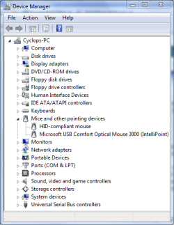

What does Device Manager show?
it shows "HID-Compliant Mouse". before i did some driver reinstalls, it said "Unknown USB Device".
