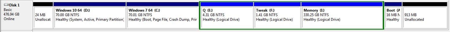

Since my last post, I have 7 on C, 10 on D (both primary partitions), 7 boots and 10 doesn't beyond the boot screen & I currently have 10 as default to try the various start up tools but not much happens beyond a dark illuminated screen and a movable cursor.

I have discovered the boot partition that had been left behind in the move, restored it and copied it to the SSD with EaseUS. Is there a way to manually reunite this with the 10 OS on the same disk?

I'm not sure what all you've done and have/had in Disk Management (DM).
You never posted the requested proper DM screen prints.
You should post a maximized/resized screen print of Disk Management using these instructions:
Disk Management - Post a Screen Capture Image
You could try using a Win 7 install disc and do a Startup Repair and see if that fixes your problem, here's the tutorial:
Startup Repair

Win 7 works absolutely fine, it's win 10 that didn't boot........and now that I've found the hidden partition and copied it to the other disk where both remaining OS are, I am wondering whether there is a way to manually reunite the win 10 partition with its previous boot environment before hiding the latter.
I cannot see how a startup repair on 7 will help me getting 10 to boot.
It's coming along, but really only in fits and starts.

I did not say Repair Install !
I said Startup Repair.
I have used Startup Repair many times to fix issues on my multi-boot PC's.
It's always to fix self-inflicted wounds i caused by restructuring partitions/changing OS's/etc.
I've done a Startup Repair with a W7 disc that fixed a problem where no OS would boot on my triple boot test box - it has W7, W8.1, and W10.

OK, worth a try. Thanks.
