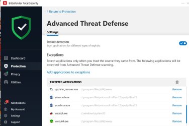

OK, So I disabled all of Bitdefender's modules and interestingly Word worked fine.
I then re-enabled them one by one and when I re-enabled Advanced Threat Detection, Word crashed again, but was a bit more stable.
I have previously added WINword.exe to the exceptions list, I have now added all *.exe relating to word to the exceptions.
Not feeling 100% this is the issues but seems a good place to start!

Just as a further update, I think I have confirmed that Advanced Threat Defence is causing the issue. However it does not seem to matter what MS applications I add to the exceptions list, Word still crashes.
If I turn the module off I have been unable to make Word crash.
I've sent a support request to Bitdefender.
