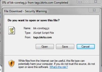

Hello all and thank you UsernameIssues for your advice.
Ok update; I ran WDO and did a full scan along with a quick scan afterwards to ensure everything was picked up. It did find Virus OS/Rovinx.V along with a list of errors that came up with "java/sun". I did in fact update my java the same time I updated my macromedia flash. I'm fairly sure this was the reason for my laptop starting to flip out.
Although WDO has been run and found things. These have been cleaned and/or removed. I booted back up and I still have explorer.exe having memory problems.
Also - the pop up for me to download bk-coretag.js has stopped.
Any thoughts?
Thanks
-Steve

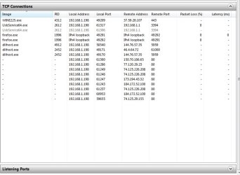

Please post a screenshot of the Network tab of Resource Monitor.
(Expand the Network Activity area and/or the TCP Connections area.)

Hi again UsernameIssues,
1) I have been using TrendMicro but it has expired. I used to have Norton in the past but TrendMicro made me uninstall it.
2) As long as I keep MSIE closed, it seems explorer.exe sits at about 90-110k. It's strange for the last 20 minutes it has not really increased yet this morning it was going up and down. It is not 'all the time' now.
I have attached what I think is what you are looking to view. Is it?
- Edit, the amount of items listed on the attachment has been drastically reduced maybe by 100 after running WDO.
Thanks a lot,
- Steve

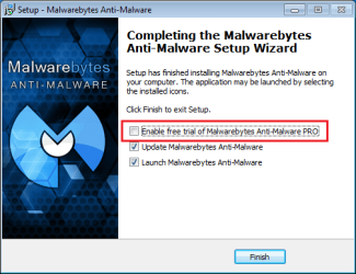

Deleting a program (even a bad one) is not always the best thing to do for reasons that I'll not bore you with.
Since Malwarebytes found the app to be malicious, let's see if Malwarebytes can get rid of it for you. Install Malwarebytes from here: Download Malwarebytes Anti-Malware 1.75 - FileHippo.com
After the install is almost complete - you should see this:
Uncheck that offer and let Malwarebytes update.
Wait for MSE to complete its scan before running Malearebyte's quick scan.
We do want to start with the quick scan to get rid of things that might hamper a full scan.

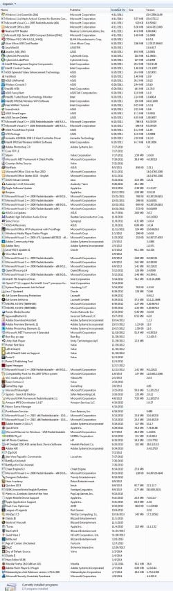

In the meantime, attached is a list of the installed programs.
Thanks,
-Steve

Thanks for the list of apps.
I would uninstall Core FTP LE - unless you use it.
If you do use it, then consider updating it.
I see that you have SpywareBlaster 4.6 installed. If you are going to use an app like this, then you need to keep it up to date. SpywareBlaster 5.0 has been out for a while now. You will need to manually check for updates a few times each week or buy the software to get automatic updates.
Pando Media Booster is questionable. If you know that you have to have it for a game, them keep it (for now).
Uninstall:
Java 6 Update 31 - if you must have Java, update to the latest.
Ad-Aware Antivirus (it is best to only have one antivirus app installed)
Ad-Aware Browsing Protection
Best Buy PC app
Adobe Reader 10 (install version 11)
Adobe Air (you can put it back if some other app complains that it is gone)
If you have a lot of plugins added to Firefox, the just update Firefox to version 27. If you don't use Firefox much, then consider moving to a 64bit version of Firefox for better security. I use Pale Moon, but there are other good ones too. Or, just uninstall Firefox all together.
I like IE and its security features, but it is very important to keep things like Java and Flash up to date. You might want to consider using Chrome as your default browser because it should update itself and Flash automatically.
I also suggest the people keep two browsers in case one gets hosed:
IE, Firefox, Chrome (pick two :-)
