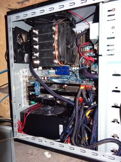

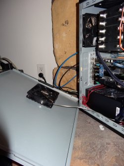

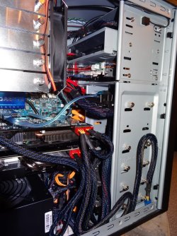

I just purchased another GTX670 2GB (2 fan ASUS) to go with the one that's been in my system (3 fan Gigabyte Windforce). Both cards do rather well thermally in the Valley benchmark with the Gigabyte reaching 59C and the ASUS 63C when they're in the box alone. Things become uncomfortably warm when I hook them up in SLI as they are extremely close together and there is little room for the Gigabyte (top card) fans to blow its air out. When in SLI the Gigabyte hits 77C and the ASUS 67C. The first time I ran it in this configuration the PC crashed during the benchmark. Afterward I increased the speed on the two front intake fans and it was able to complete the test multiple times.
I attached some photos of the rig and would like some suggestions on what I can do to cool the top card. I don't think putting the ASUS on top would work because it's the warmer of the two cards to begin with, has a metal fan shroud (which could short the back of the Gigabyte), and the longer Gigabyte needs the space up there.
Fan setup is as follows:
2 fans in the front sucking air in over the HDs. They are on a manual fan controller.
1 side fan blowing air in between the power supply and the graphics cards, also on a manual fan controller (should it be blowing out?)
1 fan blowing air through the CPU heatsink (CPU_FAN control)
1 case fan blowing air out of the case on the other side of the CPU heatsink
1 case fan blowing air up and out of the tower (2 position speed switch)
1 bottom mounted power supply blowing air out of the back of the tower

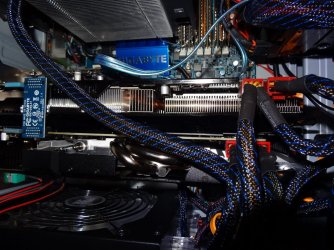

Tbh, heat shouldn't have been a factor. I had a tri 670 sli setup and the top and middle card were quite happy running in the mid/high 90's. 77c shouldn't be an issue. (aside from not hitting the full boost clock speed)
You can certainly try reversing the fan - but typically the side is always 'cool air in'.
Short of upgrading your case fans to ones that push more air, unfortunately there isn't a whole lot you can do. Partly because of the gigabyte dumping heat into your case, but mostly it's just how SLI is when two cards are sandwiched together.

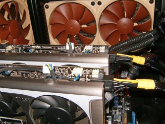

Mine were windforce models as well and I actually placed a 120mm on top the primary card right over the backside of the gpu core - but it may have net me a whole 1-2c difference if that.

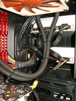

You could try to tidy up the cables and shove them more into the drive bay area to create less of a wind flow blockage from the two front fans.
Maybe add another 120mm fan behind the cards and remove that last top bracket to make a small "exhaust".
Create a custom fan profile with afterburner/Precision X to increase the cards fan speeds if you haven't already done so.
With SLI and sandwiched cards - noise and heat are always going to be a factor.

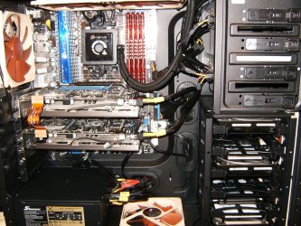

I start off simple.
Cable management. Those cables are blocking most of the air coming from the front fans.
If possible you could also remove the front cages if you are not using them.
Without moving things around I don't see anyway of getting air in and out of that case.

For sure I would look into a new case with cable management area behind mobo. Here's a Corsair 400R that's cheap enough but lets things breath.

Thank you linnemeyerhere for the pictures.
As the pictures show better than words you must have a well organized case in order to get proper air flow. Getting proper air flow will also help your cpu air cooler do its job.
It might take a new case in order to run two video cards cool.
We can help with the selection if need be. Their are many good cases in various price ranges. As you can see the Corsair 400R is a good workable case for not to much money.
The proper power supply is a must x-2 running SLI. We can also help with that if need be.
Omegaman007 I and others are not saying don't run SLI. Many do and like it but their are things that have to be taken into consideration when doing so. Or you will go from happy single video card computing to very painful dual video card computing.
Letting us know what system you have will help us help you.
Nice build linnemeyerhere. Thanks again for the pictures.
