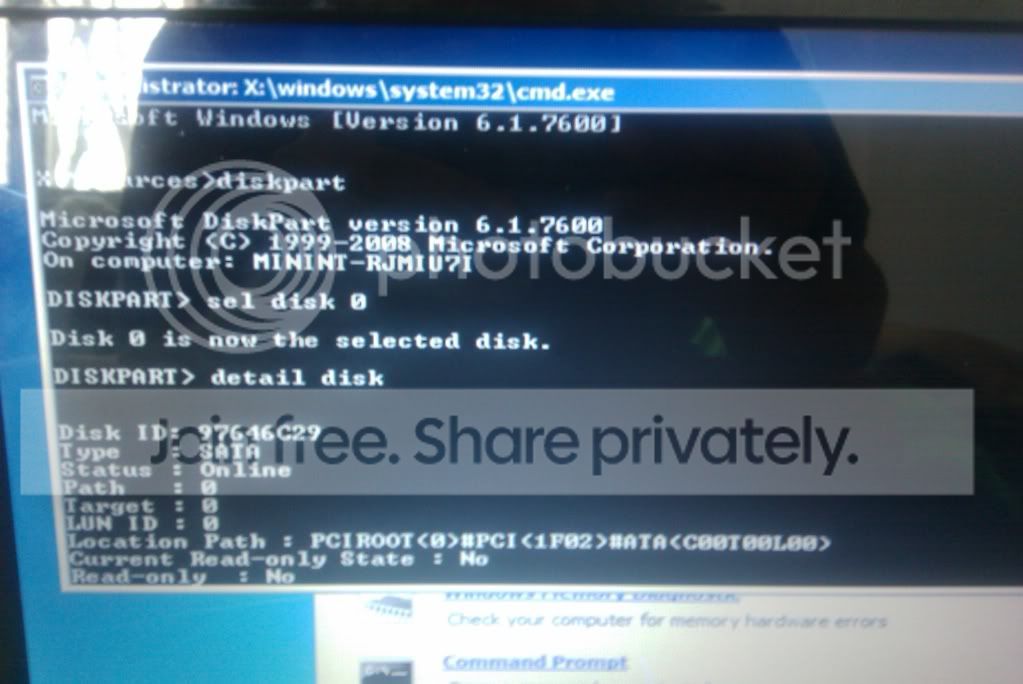

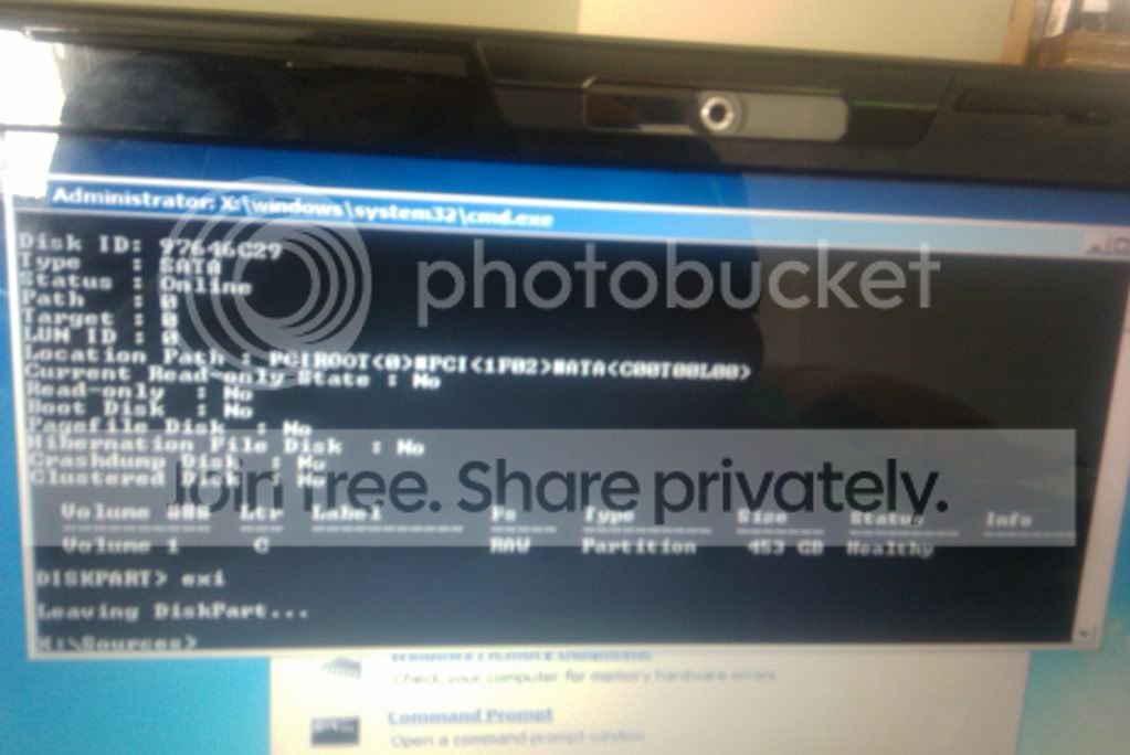

ok these are the pics i took when i did it.

The drive is shown as Raw. That means windows doesn't think it contains a filesystem . The repairs you tried will do nothing to a Raw drive.
Try booting The PW cd ( make sure NUM LOCK is on when it asks about screen resolution - then press1 , then press enter).
If it sees the drive, click Disk 1 at the top of the PW screen , then Partition Recovery in the left pane. Do a Quick scan . If it finds the partition (s), tick ALL the partitions you want back, OK, Apply.
