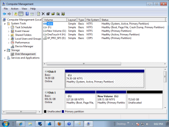

Before you disconnect the "old" HDD please post a snip of Windows 7 disk management for us to look at, to be sure there will be no boot issues when the HDD is no longer connected.
In the Windows start menu right click computer and click manage, in the left pane of the "Computer Management" window that opens click disk management and post a maximized snip of that.

Bare Foot Kid asked for a screen shot and I believe that I have uploaded 2 different formats I hope that I did as asked. This is my first effort
1) Remove Disk0 (80gb) & replace with Disk1 (1tb)
2) Setup your dual boot.
3) When the dual boot is working OK, plug in the failing HD & Copy/Paste data.

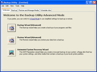

The Windows back-up recovery floppy, when used to restore my back-up from the external HDD after the malware incident, was referred to as the Automated System Recovery, I think, or maybe the "R" is for restore, Disk "ASR" during the process, using the ASR option, which is simply what the recovery disk is called as well as the process itself to restore the back-up. I did not know if the restore or recovery disk, some how is encoded with that particular drive, thus preventing me from using it to do a restore on the new XP PRO install and new drive, saving me a great deal of work getting it to where the old drive's OS already is.
