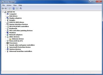

You can trace the mystery device using Hardware Identification
Does Intel Mgmt Interface appear to do anything? Which drivers did it install, if any?
Ah - cool.
Ok, so the Vendor Search popped up as Acer (my two monitors are both Acer S241HL's) and the Device Search yielded no results.
I d/l-ed the latest driver from the Acer site, and now have a folder with S241HL.inf and S241HL.ICM No .exe or other means of installing the driver. Thinking I may need to put those somewhere, I searched my Win dir. for "S241HL" figuring I might have an older version of either of the aforementioned files - I found a few.
I have an inf and icm in C:\Windows\SoftwareDistribution\Download\Install, and both again in C:\Windows\System32\DriverStore\FileRepository\s241hl.inf_amd64_neutral_1d4828331b0026a3
and a third icm in C:\Windows\System32\spool\drivers\color
Should I replace those with the new files I just d/l-ed?
If I go to the Dev Mgr and update driver, choosing to browse manually, I point to C:\Windows, and get "Windows could not find driver sw...". If I point to the folder where those new files have been extracted to, I get the same message.
Thanks!

Yep - did that. The only thing there are those previously mentioned lang. packs. Below is what my D.M. looks like. Thanks!
