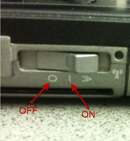

This sounds like what would happen with my old Dell laptop. It had a switch for the Wifi card that had distinct on and off positions. When it was off it would actually cut off all power to the card. I found an image of one that looks almost identical to the one on mine. Does the switch on yours look similar, or is it just a button?

It's a push button next to Power button in top center of laptop, slightly smaller, lit with orange light if offline and blue if online.
